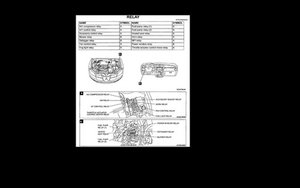

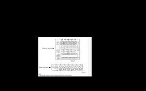

Hi,
If the horn button on the steering wheel is not literally broken have you checked that the horn fuse and horn relay are both OK.
This shows the location of the horn relay.
I may be considered over the hill but I can still read small print, but this is ridiculous. Make it LARGER so that we can read it without a Magnifying
glass. Please.
@Peter Rushbrook
If you hover the cursor over the image there is a magnifying glass symbol. Click on that and the image enlarges. Click on the enlarged image and it enlarges even further.
