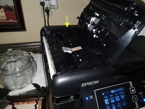

I have puzzled over this issue for awhile trying all the above. And then I took a pen and gently inserted it into the small rectangular access hole with the little white “arm” in it. Move it forward a bit until you see and hear it pop undone. This little arm engages the white drive gear an inch or so in front of it which in turn drives the paper roller shafts built into the top door of the ADF. Good luck!

This WF-3640 printer is about 5 years old and the ADF has never worked until now. THANK YOU
Excellent tip!!!! I had a wf-3640 given me and I was able to fix the firmware but up to now the ADF was a non-starter always showed "paper jam" every time I attempted to use ADF. Now it works perfectly and I setup a couple of presets one for duplexed letter size and one for single-sided letter size copying. Thanks this made my day!!!!
This photo refers to the ADF fix added by @artfullservent 1/29/2019 Hopefully this gives a little better context of how to find the part that needs to be shifted to get ADF “back in gear”. Pictured printer is Epson WF-3640 with ADF lid open. I suspect this pops loose when scanning thick paper media that overloads the mechanism or something similar and apparently is common to multiple models of WF range epson ink jet printers. Thanks for the suggestion Brian!
i wish the photo was clearer
