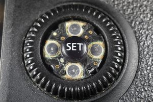

Disassembly may not be necessary (and cleaning may work):
We were about to follow the disassembly procedure but - having seen the picture - decided to first try to simply pry off just the controller cap.
That worked nicely (the hooks are placed diagonally, the cap is rotated in the image)
exposing the contacts:
In my case there was little corrosion but the two malfunctioning contacts would only work sporadically when pressed directly (leaving it in the camera allowed for easy checking). Pressing the contacts repeatedly seems to improve their response, however, after putting the cap back on the old behaviour returned - non-function.
On a second attempt a minute amount of contact spray was applied to each of the contact plates and again the contacts were pressed a couple of times to “massage it in”. This time it worked and the controller seems to have regained its function on all contacts after refitting.
The contact spray may have been the crucial difference to the previously discussed attempts.
I hope it stays that way for a while … and that this simple procedure may help others

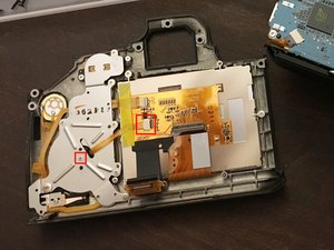

If you follow this guide, you can take off the back panel. From here its relatively easy to access all of the buttons.

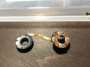

You can remove the connection and screw (indicated by red on the above photo) to take out the 8-way controller. The plastic control dpad itself is simply clipped on to the electronics and can be removed by gently pulling back the clips (I used a very small flathead screwdriver).
As you can see underneath was quite dirty, and cleaning it has helped somewhat but not completely. I will need to source a new 8-way controller despite the cleaning! :(

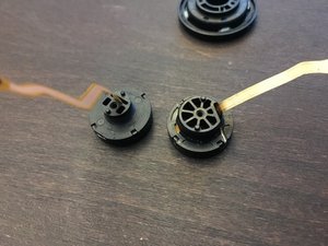

I don't have any pictures, however I was also experiencing the above problem with one of the buttons on the 8 way multi-controller (right directional in my case, only worked if pressed very hard), and went ahead with the flex cable replacement from eBay (this item) after cleaning did not work.
I used the linked Rear Body Panel Replacement guide to get to the flex cable, then proceeded from there to replace the ribbon. Replacing it requires separating the existing cable from the button plastics, then an additional metal backing plate that the ribbon itself is adhered to. After the remaining adhesive is removed you re-stick the metal plate to the ribbon, then go ahead and do everything in reverse (pre-installed adhesive on the replacement ribbon is very handy).
Worked brilliantly & I now have a fully functional multi-controller for only the cost of the replacement ribbon.
