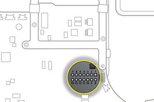

I changed my power supply twice. One green LED lit even after Power button is pressed. I unplugged power button from logic board and ohm'ed the button. OL at rest and 1.8 ohms when depressed. Momentary switch, button is good. How can I test the logic board or can it even be tested? Or do I have to change parts until it works?
Really need help with this, can't afford to change parts hoping it will work.

Here are some test points you can check.
Logic Board Test Points
Test points, which can be used to verify proper power flow, are accessible on logic board when LCD panel is removed. All voltages given in Troubleshooting Symptom Charts assume that computer is plugged into a known-good power outlet with a known-good AC cable. Some guidelines for using test points:
• Warning: HIGH VOLTAGE: Use extreme caution when live testing!
• Do NOT lean over or touch the power supply area during live testing.
• Keep your fingers behind finger guards on test probes when measuring.
• Turn dial of voltmeter/multimeter to measure DC (direct current, usually indicated by a solid horizontal line over dashes). If your voltmeter requires a set voltage range, choose a DC range that includes the voltage you are measuring.
Logic Board Test Point Function
Pin 1 Ground
Pin 4 Standby 12V power (permanent power coming from power supply and present as long as AC cable is connected, even if computer is off); corresponds to LED #1
Pin 6 Backlight Control pulse width modulated signal (from logic board to LED backlight board, to adjust the backlight level setting according to user setup)
Pin 11 12V Run-Mode power to logic board (coming from power supply, present as long as system is on or asleep); corresponds to LED #2
Pin 12 Power On Request signal (from logic board to power supply when power button is pressed)
Pin 13 Backlight Enable (signal from logic board to Backlight Controller board, to enable backlight
• Connect black probe to ground. Connect red probe to test point and verify voltage.
Let us know what you find out.
