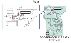

I have the same problem with my Power Shot A620, 7.1 MP, s/n is: 0926105205. . No LCD. Camera works fine through view finder. The CMOS battery measured good. Not sure what PCB view was shown on this post but my schematic looks nothing like that. Could find no fuses. Any idea what replacing the LCD would cost? Probably cheaper to buy a new small camera . Is that the view of the PCB on the LCD or is it from the camera body? I am a retired Electronic Technician. Any idea what a replacement LCD would cost?

Pete Chisteckoff post an image of your logic board (front and back) with your answer (actually a question)so we can see what you see. LCD's for this camera are around $25USD at places like ebay :-( etc.

You'll find the fuses on the underside (primary side) of this board. Here is the image about the fuses

Still confused. Where is the logic board? I only looked at the LCD board with the battery. Doesn't seem to be anything behind that board. If the logic PCB is in the main camera body I need to know where and how to access it so I can check the fuses. I have never opened up the camera body.

Thanks for the info. I disassembled the camera and checked the fuses. They were okay.
Guess the LCD is shot. Not going to fix it. Found my receipt and I bought this camera October 2005!!
