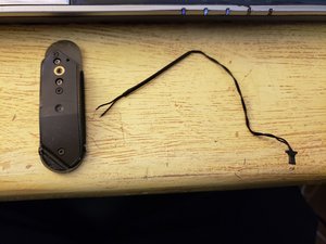

when i replacing the HDD for an SSD in my machine. I cut the power cord from the power button.
someone could help me with a tutorial video or maybe writing about how to replace this piece ?

Ouch! So the cable is completely cut. You should be able to splice the cut sections together the button is not polarized so you don't need to worry which way it's wired. If you must add a segment of wire to give you enough length as well as make it so the seams don't get in the way. Some heatshrink tubing should do.
Here’s a quick overview on how to get the button housing out of the case. I got so mad at the prospect of having to buy an entire new rear shell because of one little broken cable that I resolved to find a way. It’s epoxied in, so take a deep breath, find some inner calm and then arm yourself with a heat gun. Remove all the extra stuff anywhere near the button housing (including that little strip of black folds that runs along the bottom of the screen area, held in by five tiny screws). Point the heat gun at the back of the case, just where the button housing sits. Let it heat up real good, and then take a spudger or small flat screwdriver and try prying at the button housing. Be patient, it took me about ten minutes of heating and poking to get it out. But it is do-able, and when you get it, you will attain a deep and magnificent joy. When putting it back, use hot glue to make life easier for anyone who might have to get it out again.
Thanks! The heat gun did the trick. Even the adhesive strip stayed intact, so I could just put the button back in the case after soldering.
What heat gun do you use (brand and model)?
Paint stripper 2000 Watt. Heat the corner, avoid the button and it will fall off by itself.

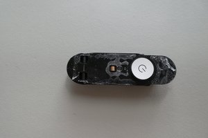

Im a fool and did the same thing , I managed to get the power button out, now the only question would be , wherer to solder it ?
since it came completely of, do you know where to solder it ?
Photo attached
Ok found out what to do , for those looking for an answer, you need to open the button case, inside you'll find the cut wires ,
Solder the wires directly to the pads where the connector was. Makes no difference which wire went to which, the button simply completes the circuit -power pad then to ground pad turns smc on.
Does anyone know what type of wire is used for this part? I’d like to get a longer wire to splice in as I lost quite a bit while trying to remove the outer casing.
I had to splice in some wire - I had an old mouse sitting around, so I snipped off a bit of the usb cable and used one of the several little wires inside. It worked fine! I don't think the exact type of wire is important, just so long as the gauge is similar enough to allow a decent solder.
The wire needs to be very very light. It rides on the switch and the flex becomes part of the movement of the button. I had to also carve out the switch cover so the wire was not binding. I used a 45 watt tiny tip and the soldering was easy.
