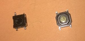

I have a similar problem. When I plug it in the light does turn red, but I can't I get the unit to come on. For a while it would work only if I held down on the power button for three seconds, let go, then pushed it down briefly. Now that does not work either. The unit simply will not come on.
The swith welds are of poor quality...
With a weldering iron , you can repair you Trek.
The rubber band is easily lifted ;-)
Edit 02/2018: It's better to change the switch (Left : original Right : new)
It may not be a faulty button as much as a faulty battery that won’t hold charge anymore. Does anyone know why there is 3 cords out of the battery? White red and black makes me think the white one has another function that stops the Unit working when plugged into power point if battery is faulty.
