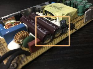

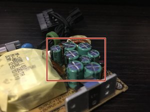

My Time Capsule died again, and this time the LED is not turning back on when I plug it back in after a while (the hard drive still runs, though). So, I decided to finally dig in and see what the problem is. Looking around on Google and eBay, it seems that the reason why my problem happens is because the capacitors get blown on the PSU, and therefore need replacing. Before I ordered any "capacitor kits", I wanted to see if this was true.

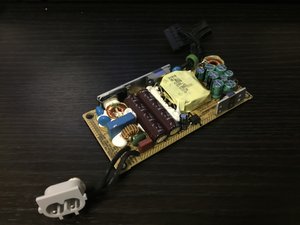

  6. Both the HDD and power supply were not screwed down, and thus I was able to simply lift them out of the assembly.

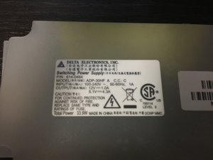

Apparently, this generation of Time Capsules are shipped with varying power supplies. Commonly, they are found with Flextronics units (P/N: 614-0412, 614-0414, or 614-0440). Less commonly, in my case, they are shipped with Delta Electronics units (P/N: 614-0464). While they both are specced similary and have the same connectors, the output differs ever so slightly.
  • Delta Electronics PSU
    • Output: 12V==1.0A, 5.1V==4.3A
    • Total Power: 33.9W
  • Flextronics PSU
    • Output: 12V==1.2A, 5.1V==3.8A
    • Total Power: 34W
Upon closer observation (see the pics), there doesn't appear to be blown caps at all! It looks absolutely normal... yet it doesn't work. Guess it's another component that failed?
