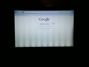

TurboHommy, from your description it sounds like you are saying the shadow from between the LED's from the backlight. This can happen when the backlights rotate during manufacture of the panel. Post an image of what your panel looks like with your question. Use this guide for that. I envision something like this
Yes thats exactly it but they are always along the left side at all times. not quite that long though as in your photo. Its on an ipad air. I was very surprised when a new LCD didnt fix the issue.
The length of that depends on the amount of rotation by the LED backlight. The backlight consist of multiple different strips, so yours is the left side strip. The LED driver circuit on your iPad's logicboard really just turn the LED's on but does not impact the rotation etc. I'd try another screen.
