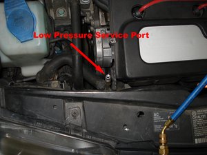

how do you identify the ‘low side’ on 2005 vw jetta ac unit
How many cans of freon does it take to charge
Ang, make sure that this is your problem. Double check to make sure that your temperature control cable works properly, Anyhow, to answer your question you recharge the ac from the low side valve/service port. It is located to the left of the engine close to the windshield washer reservoir. Follow the ac line on the left side of the engine facing the engine. The refill kits that are commonly available will only fit that port.

Smaller of the two fittings - large AC line is suction side - small port - charge here. Small line from compressor is high pressure side - larger of the two ports - monitor high pressure here if charging with a gauge set. Not necessary if just adding freon - add freon 134A till low side reads around 45psi
