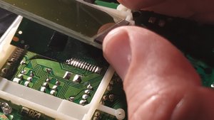

I have an original game boy that when turned on, the LED is red and you can hear whatever game is inserted, but no visual on the lcd screen. The contrast switch has no effect.

Another option now is you get mod kits with an updated lcd screen with backlight that replace the screen and board assembly in the front of the game boy. It does require removing two of the screw pillars though and soldering on a new speaker.
I would check to see if the pot that controls the contrast is functional with a multimeter. If it isn't, replace it and see if that solves the issue.
I would also check all components on the PCBs for signs of damage, e.g. burnt transistors, charred board, leaky/dry electrolytic caps... If you identify any bad components, solder in a replacement and see if that works. There are some decent Game Boy schematics on dev'rs if you need. Link: http://www.devrs.com/gb/hardware.php#har...
From there, there's not a lot of places to go. The most likely cause of the issue is what Andrew said. The thin ribbon cables used to drive the LCD were actually sandwiched inside the panes of glass that constitute the LCD. There is a thin rubber strip with adhesive running along the bottom edge of the LCD to create pressure when the case is closed in order to maintain a solid connection.
Over time people would frequently (even if inadvertantly) expose their Game Boys to sun or other heat sources and these ribbon cable connections, particularly the bottom one, would come apart from the LCD. This is what commonly causes lines in the LCD or complete lack of LCD function.
The fix for this problem would be a replacement LCD screen, but finding a working Original Game Boy LCD screen by itself is fairly unlikely. Your best bet would be to buy a known working Game Boy and keep this one as a spare parts source for the working one.
Most likely you have a problem with the connections to the screen. They are fairly fragile and over time can malfunction and be completely un-usable. At this point you can go inside the game boy and look to see if anything has come apart, but your best bet would be to find a new Game Boy.

Sounds to me that the contact points in the front ribbon cable (below screen) have come undone, or loosened over time, a common problem in older DMG's. All you near to do is open the console and remove the rubber gasket from around the screen. The, see the brown ribblo cable directly below the screen, that is what the problem is. You near to turn the contrast all the way up to make the screen black, then take a soldering iron and lightly press on the ribbon right along the bottom of the screen, and run the iron back and forth until the you can see the image (keep power on the whole time) this should work but good luck anyway. Also, do this at your own risk, as I am not responsible for damage:-)
I solved recently this issue in a Gameboy, the problem was the thin connections between the ribbon cable and flexible PCB allocated under the LCD screen, you have to slightly separate LCD screen and with a soldering iron, pass over the unsoldered connections .
