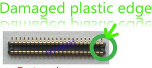

In my case, after a screen replacement, i pushed the Digitizer connector with a tiny bit force more, than the connector accidentally damaged.
Was easy to fix, with a metal tweezer, hope it helps ;)
