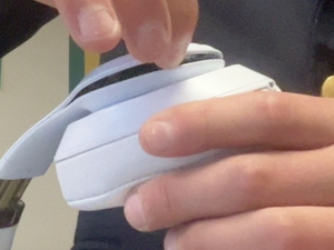

Why are my hinges loose on the headphones
My beats solo hd they fold when i move around they dont stay firm

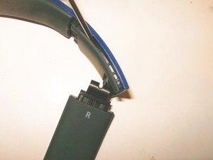

blade6462, loose hinge pins can cause this. Remove the cover plate on each side and you will see how the pins are inserted. It is possible that either they are worn or the holes where the pins go through is starting to wear out. Sometimes you can fix this by replacing the pins with slightly larger ones.
