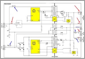

Check the fuses (blue) for continuity and check the voltages (red) on the connectors. Let us know what you get.
oldturkey03, Thanks for the suggestion. Tried it but no luck. Test picture works just fine. Error log lists Usage Time: 1337 Hrs Code: 0048 Status: Happened.
Any other ideas?
I am sure we can come up with some more stuff. You pretty good in taking stuff apart? Remove the back on your TV and lets look at the boards. Luckily we at least know that the LCD is ok. The rest are all just board issues. Error code 0048 is usually related to 3.3 and 5v line short which is a problem with the main board. Need images of your boards to see if this is a capacitor issue or something else. Post some with your question. Here is the guide for doing that Adding images to an existing question I should have the schematic for this chassis and I will see if I can find where we can check the voltage. No giving up on here:-)
