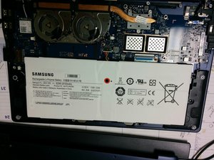

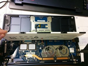

How to upgrade SSD?
I've opened the back cover and removed the battery, but I see no mSATA. Where is it?
Update (09/25/2015)
Please see the pictures I've posted of the inside of the Ativ book 9+. Is there an mSATA SSD in this laptop?
Update (09/25/2015)
Attached pictures.
i cant see any mSATA on this board. There is a place where it says 2nd SSD but as far i can see there is no connector. I think it is not possible to build a SSd with mSATA in this Laptop.
Sorry to say that.
Hy William
When you open the Notebokk, is there a orange cable on the left side of the Batterie?
if yes, under this cable, you will finde the mSATA connector.
Greetings
Daniel
Unfortunately, no orange cable. There is a piece of plastic, looks like a spacer. There are two wires connected to this piece of plastic, very thin wires look like power, red and white.
If it is possible to post a picture here, I can share a picture of the inside of the laptop.
You can ad a picture by making a new answer and click the picture button
