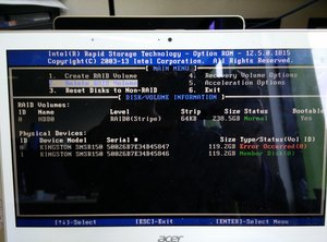

Customer brought in an Acer Aspire S7 saying for a number of months the system has failed to boot, suspected that the HDD wasn't connected fully, these boot failures had been intermittent.
I have checked the physical hdd and all seems ok (as manufacturer intended, not one bit of tampering)
But on boot I get a warning and an option to press CTRL+I, if I don't it seems to boot normally on the occasions I have tried but if I press CTRL+I I get the screen below.
Note: Option2 is "Delete RAID Volume"
Any ideas?
Thanks in advance for the advice!!
Will
Will I have just had the same issue with an S7-391. At this stage the only fix I could do was to replace the SSD as the RAID 0 was corrupted and everytime it booted Win10 said it detected a problem and would repair it then reboot to face the same issue. I am still trying to recover the data with no luck as yet. So I would suggest before you do too much more is copy all the data off first then reformat the drive or fix the raid array. I hope this helps as doing this I thought I was reasonably secure by backing up my stuff but now can see Windows had stored files that I do need all over the place and not in the folders I backed up.

Hi, I am also currently facing the same issue. I booted Ubuntu and performed extended SMART scan using the disk utility - the status shows OK. Did you guys ever managed to fix this?

My wife's S7/391 has just shown the same problem. The error was in the second block and nothing would repair it or allow the device to boot up the Windows 10 operating system.
What I did in the end was to generate a Boot CD on another computer (Windows7 Ultimate), and use this in an external usb DVD drive to boot the Acer in Win7. This gave me access to the files in the Acer which I copied to a USB stick.
Once I had the personal files backed up, I deleted the raid configuration, (along with all data and programs), and repartitioned/formatted the SSD as two separate hard drives, C and F. Windows 7 was then installed in C and data stored in F. (I consider Windows7 an upgrade from windows 10 ).
(Note: I also changed the boot configuration in the BIOS to Legacy ).
This reply is being written on the rejuvenated Acer and there are no errors yet - time will tell though.

A friend of mine recently faced the same issue. The Raid 0 set up of the 2x128 GB shows that there is an error with one of the drive. I only have option 2, 3 or 6. It is from an Acer Aspire S7-392.
Running Ubuntu disk check shows that SMART test passed for both drive in Extended scan mode. Since it's not a regular SATA port (it's an mSATA) - I guess i need to use an adapter to plug it to my desktop - and then I don't even know if it reads since my desktop is in AHCI mode.
