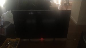

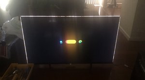

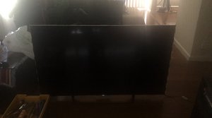

6 red light blinks, after right side of the screen becomes from normal bright to dark.
I removed the back panel and the top and 2 vertical side frames: all the side led are bright for 3 seconds, than 15cm of the top right led, plus all the vertical side led line turns off, blinking then red and obviously turning off.
During the time the screen tries to turn on, everything seems normal and that’s when the Android operative system tries to start.
I’ve changed the power board, without any success.
Is there any one here can give me a clue, please.
I took a video showing the issue, if it can help anyone to understand better the technical problem.
this is what happens trying to turn on my tv
Try pointing a bright light at your screen if it power’s on all the way turn off the back light,if not it’s your power supply try tapping on back of tv just replaced mine again after 5 years it’s important to keep the backs clear of debri so they run as cool as possible
Thank you so much
for your reply Hutchinson.
But I’m not sure about the test I should try.
Do I have to do it with the power on, during the normal start?
I’ve already changed the power board, with not any difference (I’ve got 2 power boards now!).
I’m worried a part of the linear led lights are broken, but I’ve got no idea how to fix it, if it’s the problem.
By pass the bl error cable to a ground. Then you are ready
So if you have changed the power supply and it’s still doing it it leads me to believe that you have a backlight problem and the only way to fix this is exactly what you are fearing get the brightest light possible or put the tv in a extremely well lit room so during start up it won’t call for the backlight to come on once it powers up go into your settings and turn it all the way down or off
If none of this comes to a resolve then you most likely have burnt row of leds
