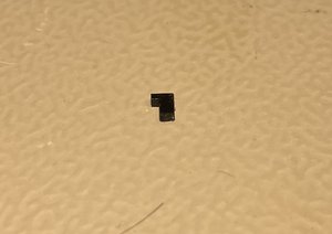

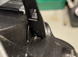

Situation: Nikon D5100 built-in flash would not shut. Found a small plastik “hook” lying near the flashes hinge. The flash would still pop open, but a bit weakly. Found the hook to be an anchor point for a second “open-flash-spring”

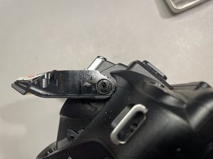

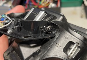

Remove two screws, carefully remove flash cover:

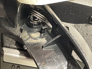

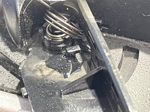

Where the spring should be:

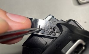

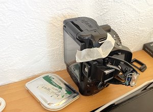

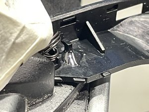

Use painters tape to pull spring away from glue point to prevent it from beeing glued together:

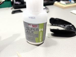

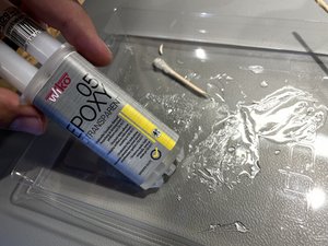

CA-glue (= super glue/ Sekundenkleber). I like the 60-second version to have a little more time:

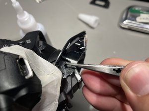

Hold plastik hook with tweezers, put a drop of CA-glue on a throw-away piece of plastic, tip plastik hook with broken side into the glue dropplet so that a small dropplet of glue sticks to it, put it back to where it broke off in the orientation shown here:

24h later, put the spring under the hook where it belongs:
Make sure the lower part of the spring, which presses against the camera body is in it’s correct position:
Clip on the flash cover shell without aplying force. Try closing the flash half ways or fully, reposition the thing, open the flash again… eventually the cover will sit perfectly with no further broken off parts. Then put the two screws back and baam. There you are!
