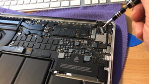

Okay, here's the rundown.
A1502, purchased in March 2014, has suddenly created a pretty nasty problem.
Went to boot one day and *chime!* but no screen. Apple logo on the back lit up, backlight was obviously working, but ZERO display workings.
Okay, so I plug in an external monitor. Nothing. "HDMI signal not detected." Okay, so I do the Googles, read the reddit, etc etc. Reset NVRAM/PRAM, reset SMC, no luck. Try booting Command+D Diag. mode, and output on external monitor! However, white progress boot bar hangs at 1/2way for 3.6 hours. So I Safe Boot (Power+Shift). Finally, I can use my external monitor! I can get into my mac and mirror displays, so that I can offload my data. Great.
I know the int. screen isn't working-- that's not the discussion.
Here's the question: When I boot normally in clamshell-closed mode, external monitor works perfectly. But the second I open the lid (i.e. use keyboard) EVERYTHING GOES BLACK AND TURNS OFF. Then, I must boot into safe mode to use the mac again! And the cycle repeats itself... What is the culprit here? Iris video card, Logic board, loose internal connector, or all of the above? Is the internal display issue and this issue related at all?

Its the LVDS (display cable) problem, try reconnecting the cable again
worked for me but replace lvds if it dosent

Had the exact same problem as you after my MBP had fallen off the bed.
Had a completely black screen - not even a backlight. Tried tapping on the casing near the display cable and pushing the black bar in at the back of the laptop but it did nothing. Tried resetting NVRAM/PRAM - nothing.
I realised that I could log in and suddenly the keyboard and Apple logo lit up and the backlight was working so I figured there was something wrong with the screen. Connected it to an external display and got nothing but then I tried booting it whilst pressing cmd + D and it worked on the external display, however it completely shut off as soon as I tried to log in.
Eventually realised I was going to have to open the case to see if the display cable was damaged. I've never done this before so was a bit nervous but I ordered a screwdriver set from Amazon and waited a couple of days. Followed the guide posted above to open the case and located the display cable. Tried wiggling it a little and screwed the case back together and frustratingly it did nothing. Almost gave up at that point and was resigned to the fact that I'd have to take it to get repaired.
However, I gave it one last go except this time I disconnected the battery and the display cable and plugged them back in. Put it all back together, turned it on and BOOM! Screen turns on, everything back to normal! So relieved that I've fixed it!

I can't remember exactly which one it was but I think it was this one:
MacBook Pro 13" Retina Display Late 2013 Display Assembly Replacement
Just skip steps 7-10 as it's not necessary to remove the fan/antenna cables/iSight camera. Unplug the display cable and plug it back in and see if that works.

I tried all of the soft reboot solutions and nothing worked.
I dug a little deeper and found information about the display cable and that it can become loose.
I simply tapped on the bottom of my MacBook a few times in the position of the cable and suddenly, there was life!

since I was so happy that i found this post as it also helped me to fix the “backlight-only-issue” on my Macbook pro (ate 2013, 13” Retina, A1502) I just wanted to share some notes how it work for me.
So, I also faced the issue only backlight was working but no graphic/screen at all. Chime was there and ext. display also worked.
I simply opened the back of my Macbook unscrewing the ten pentalobe screws (TS4 / 1.2mm). Next, I just wiggle/press+pinch that cable around the connector you’ll find on the top/right (s. att. picture) and my display starts working again. Took me 5 Minutes to fix and it’s still working since a few weeks now.

I tried reseating the connectors or tapping the case but it didn't work.
What worked for me after dropping was to adjust the cable position by pushing it further towards the screen, noticed it looks a little frayed (probably due to the hinge design).
