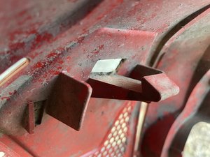

Hi, I need to know how to remove the three small nuts holding the engine cover on. They are very tight and I don't want to damage the corners by sheering them off. Any help would be very welcome. Cheers Jim

Jim, not quite sure where you are stuck. Attached image shows the individual parts for the top cover. Also, take a look at this decent video on here The service manual describes it as "Remove Engine Cover Insert (if equipped) and Cover

It is possible that all three studs have come loose when you tried to remove the three nuts. In that case it'll be a bit tough and you would have to try to take the engine cover off with it. Continue to turn the studs to see if they unscrew from the engine and apply some upward pressure on the cover.
If you take out all screws on the engine cover and you still can't get it off because it feels like there's still something holding it in the front, peel the sticker on it from the bottom and you should find a square slot. It's a clip. Stick a screwdriver in the slot and push the clip towards the back side of the mower.

Yes, that worked. The cover came off once the clip was displaced with the screw driver. Thanks for the info. No comment about who designed the application of the decal.

Once I knew about that clip, I felt around and found the slot where I applied a screwdriver to pry without pealing off the seal. Just poke a slot in it. (As if that seal was an important piece of art)
Thanks so much. Finally after 15 min.
Yes unfortunately do you have to poke a hole or at least cut a portion out of the decal but if you run your finger there you’ll find the outline and use a razor knife as I did and you’ll see what’s underneath. A slotted screwdriver pushes the tab back which makes it easy to lift the cover off…
