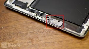

You most likely cut the wifi cable upon removing the digitizer. This can be very difficult not to do. Pull the digitizer back up and inspect the cable that is screwed to the frame to the right of the home button. See attached picture for location.
