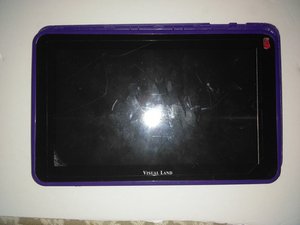

I bought a new digitizer touch screen for my visual land prestige elite 9q tablet, but I do not know how to replace it. I looked for the two screws, but I cannot find any screws to replace this screen. If you know how to change it out, please tell me step-by-step how to change it out.

Does no one have the answer to this question? I am having the same problem. My Grandson accidentally cracked the screen on my prestige elite 9q tablet and I have opted to change it out myself. I am wondering if it opens like a cell phone? Do you just go around the edges and pop it? There are NO SCREWS in this thing!

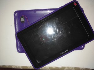

I HAVE THE ANSWER! The tablet pops apart like a cell phone. CAUTION: Remove any SD cards before attempting this. I didn't and broke mine. Fortunately, there was nothing lost. There is a small slot on the left hand side of the tablet across from the on/off button.
Sorry if these pics don't show up. I'm new here. I used a nail file to start, then a flat head screw driver. (The only things I have.) Be sure to pop the front cover and not the back. The front is more flexible and easier to pop the tabs open. That is as far as I've gotten. I suggest YouTube videos for the rest.

You must pry off the outer casing very slowly, remove all screws on the inside, there's only 2 maybe 3.
The monitor will be the hardest to come out,
The touch screen connects to the component sheet inside, careful not the bend or crack the wire connector, else you will need another touchscreen
