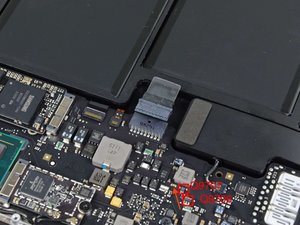

Hi,
I have a problem with screen backlight on my MBA. The screen turns on but backlight don't. Probably I found the problem on the logic board, the yellow fuse shown with the red arrow in the image is broken.
Is there anyone can help me to find the fuse specifications?
Thank you very much.
Alessio

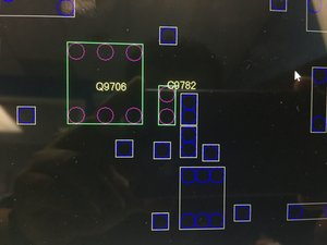

Hi Israel,
thanks a lot for your precious help providing the images.

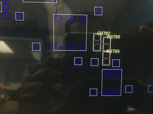

I made the resistance measurement. Since I don't know the position of the FET pins I cannot specify when in direct or reverse polarity. Anyway here it is the values:
Q9706: 299 kohm and 288 kohm (reverse). Tested on the green circles in the image posted
Q9707: 0.7 Mohm and 5 Mohm (reverse). Tested on the red circle in the image posted.
R9788: 298 kohm
R9789: 146 kohm
C9782: 95.5 nF
I hope this numbers make sense. Waiting for your comments.
Alessio
it's physically broken or it tested open circuit?
send me your MB number
If I guessed correctly your motherboard model is 820-3023
If that is correct and my schematics are right it is a fuse, however it is a 3amp 32V and it is 603-HF
Good news is that, that is the main fuse for the backlight.
Not so good news: once you replace that I would definitely check Q9707 which are the transistors that open the backlight communication. Make sure they are not bad before you power your computer on, otherwise you would have to replace that fuse again. Q9707 looking at your picture same direction and everything it is the 6 leg IC chip on the right side of the fuse.
I would also check R9788, R9789, C9782, and Q9706.
If you need more guidance let me know!

Hi Alessio!
To check if a FET Transistor is good or not do the following:
1. Multimeter in diode mode
2. Check between source and drain one polarity
3. Reverse polarity and test again
Good FET = low resistance one polarity and high resistance with reversed polarity
Shorted FET = low resistance both polarities
Open FET = high resistance both polarities
For Q9707 leg 3 and 4 are the source and drain
For Q9706 test between leg 4 and 1 (leg 1,2,5, and 6 are connected)
This repair seems very complex but it could be fairly easy. If you think the problem was pry damage then the fuse can definitely fix the problem right away. If this is by water damage or something alike then worry about circuit solving.
