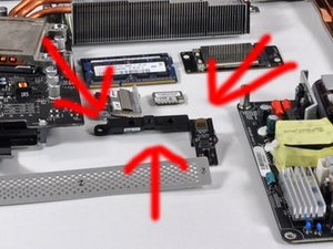

Hello for some reason my audio jack on the Imac have been pushed in so that when i connect speakers it will not get stuck anymore and the sound gets loose. is there anyway to fix this by my self?
picture showing wich part i mean what i mean:
[IMG]http://i28.tinypic.com/5uee6d.jpg[/IMG]

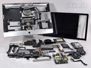

i know what you mean and i see the problem when i look at the teardown of the 27" imac
the audio jack isn't part of the logicboard - it's a plastic bracket that will become loose by only thinking of it ;-)
you can see the L shaped part in the middle of the picture
the bad part is, there is no guide for that part - but you can use any other guide to open the imac, getting to the part should not be the biggest problem - since you know where is hast to be ;-)
good luck
edit
that's the part
I can se many L shaped parts:) not possible to ring it in? well anyway thank u for the answer. I will also mention that i've had it in for this problem before and i think that it where temporay fixed that time and i really don't want to send it in again but i you have to open it i'm not sure anymore if i wanna try this my self.
Then if u look at it u can se traces of a tool around the jacket on the chassi it self so isn't there a tool i can use without have to open the mac?
i edited a picture of the part in my post above. i don't think that you could easily use a "tool" to get this part into the right position. opening the imac with suction cups should leave no marks at all. i recommend a extension cable for the audio jack after you fixed it
