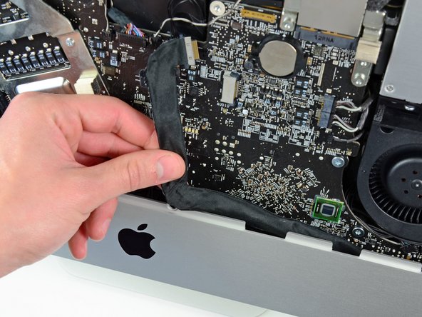

  10. iMac Intel 21.5" EMC 2428 Audio Ports Replacement, Audio Ports: crwdns2935265:010crwdnd2935265:01crwdnd2935265:02crwdne2935265:0 iMac Intel 21.5" EMC 2428 Audio Ports Replacement, Audio Ports: crwdns2935265:010crwdnd2935265:02crwdnd2935265:02crwdne2935265:0
    • Disconnect the audio port cable by pulling its connector toward the left side of the iMac.
    • Peel the audio port cable off the front face of the logic board.
