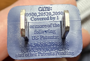

mine is just over the year mark for manufacturer’s warranty and i hate throwing stuff away if i can help it anyways, so i replaced the wall plug (theirs contains a safety fuse, which blows if you press two buttons at once or in quick succession- poor design) and it works fine now. cost 3$ and a relatively simple/easy repair.
Am I understanding you correctly? Are you saying you replaced the plug on the fan, or the outlet plug?

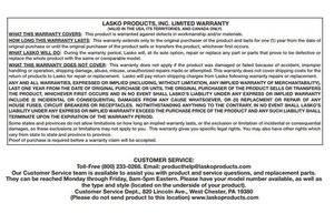

Hi @Donna Mathews,
There is a 12 months manufacturer’s warranty on the fan
Contact the manufacturer as per the details in the image shown below which was taken from the Lasko 2711 user manual about a manufacturer’s warranty repair or replacement. That’s what warranties are for.
(click on image to enlarge for better viewing)
If your fan sudden stops working. It may be as simple as the plug itself Here is why.
If your plug has Patent written between the prongs, It likely has a hidden fuse inside the plug.....
Here is what is hidden inside the blue molded plastic plug...
An online fuse with very small limited - 2.5A which means the manufacturer did not want more current than this going into the fan PC board because I guess they didn't design it to handle more though they apparently also allow more to be "drawn" into the unit at least momentarily and then you have a paper weight for a fan because the manufacturer did not create a way to change the fuse..... as you can see in the torn apart plug in these pictures. The fuse is permanently molded into the plug with no provision for knowing if the fuse "blew" or replacing it. ( Very poor desgin from my POV ).
The Fuse details:
See Patent if you are interested in what I am talking about. The above answer about replacement the plug worked for me on a different Lasko fan.Patent LaskoPlug WithHiddenFuse
