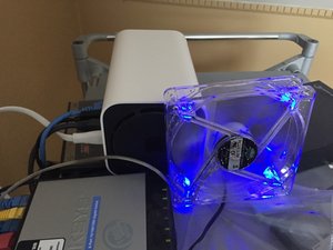

While you wait for your new fan, put a fan on it. I took a little bullet fan turned the time capsule on it's side, and created a vacuum on one corner. You need to choose a corner that "assists" the fan. The fan in the picture is blowing toward you (the viewer) and is assisting the fan inside. You can figure all this out by looking at the fixit site if it is not clear. My fan was working some of the time but the overheat warning was constant. With the fan in the picture the overheat warning would go off most of the time.
