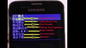

here is what you need to do in the case of this. use the volume down button to scroll to the bottom and last option on the screen. press the volume up button to select and it will start your device normaly

Here's a pic of the menu with translation. Use volume down to scroll through the menus and volume up to select the one you want. To do a factory restore on a device, choose the wipe eMMC menu. Hope this helps.

thanks for the translation! solves 1/3 of my problem.

THANKYOUTHANKYOUTHANKYOUTHANKYOU IM SCREAMING i needed to reset the tablet my fiance's parents gave him because they didn't remember the password, and i was clueless at the EMCC selection, THE CENTER!! HOW GENIUS @barbara ocone

I got tired of waiting for my tablet to die since it started at 100% battery life. I downloaded Google Translate onto my phone and used the camera option to translate the Chinese (yes, it's Chinese) to English so I could read the menu. The bottom option of the main menu said "reset smart phone". I used the volume button to scroll to that option and the power button to select it. My tablet immediately reset and went back to normal.

You press the power button to select after scrolling with the volume button. JUst worked a dream for me!
