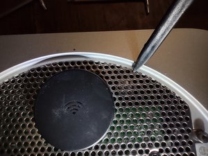

However, I encountered difficulty in re-installing the Antenna Plate, particularly the two 5.0mm T8 Torx on both sides. While it was originally perfectly fit (when I tried to remove the antenna plate), it is now re-installed with only one side of the T8 torx on either one side and the two 6.6mm T8 screws in the bottom part, leaving one 5.0mm screw uninstalled. Though my mac mini worked perfectly fine without that screw.
I don't think I have damaged or transformed the antenna plate and I believe that the antenna plate was not perfectly fit out of the box. Do anyone of you encounter this problem? Any solution?

The plate has a tiny lip that must fit into the case precisely. It is very difficult to adjust into proper alignment. The most successful maneuver I have found is to slide the plate into a loose, ready position. Then, instead of sliding straight towards the top of the case (where the 2 dots are), slide the plate at a slight diagonal to the right with enough pressure for the entire lip to ease into place.
This may take a couple of tries to get right. When it is, you'll be rewarded with a slight "Thunk!" as both ears slip into place on either side.
Then screw in the two 5mm T8 Torx screws first, then the Two 6.6mm T8 Torx screws.

Sorry I’m so late to the party, but I just picked up a 2012 Mac Mini to replace my HEIC-incompatible 2009 Mini. Upon reassembly, I also had some trouble reinstalling the antenna plate, and this page came up first in the Google. Unfortunately, none of the replies described the cause. Finding the cause led to an easy solution.
The cause is that the ridge of the antenna plate has a thin grove into which which the edge of the case must fit. Left to its own devices, the case edge will slip into one side of the groove or the other, but the opposite side of the plate will droop and misalign the case to the top edge of the groove. This allows the screw hole on the good side to align, but the hole on the opposite side is off by ~1-2mm.
The easy fix is to insert the tip of your spudger into one of the holes on the misaligned side to lift the plate slightly. With a slight push on the plate, the case edge immediately falls into the groove, and both screw holes will align perfectly.
