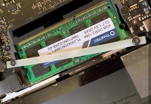

I repaired one for a customer with a 5mm cable tie I cut to span from the screws on either side of the ram slots. I drilled holes in the cable tie and used longer screws in place of the originals. He also broke the bottom retainer so I added some non conductive filler to keep them both in place when the Bridge is tightened down.
This was my solution. Wide enough cable tie measured and marked to make holes with ice pick. Used existing screws (each with different diameter threads so be careful to not make holes too big). Use fingernail clipper to cut off excess tie. I have photo but don't see how to upload into this post.

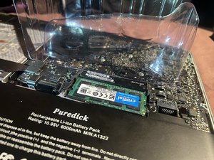

It is 2025 and we sucessfully trash repaired a Macbook Pro from late 2012 with the break both top clips method. That clear path to the screws holding down the mother board was utilized in combination with one of my co-op members new %#&*$ packaging plastic bits. Very sleek and see through!

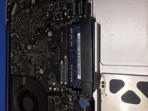

Here’s my fix with a plastic spudger
I accidently broke one clip off, stopped to ponder and came up with a what i think is a nice solution:
I went on and broke off the other clip. By doing so, i managed to create an clear path between both logic board screws to the right and left of the ram. then i went and found a thin plastic piece, which i cut to the correct rectangle size and drilled a couple of holes, one on each side.
I then seated the ram in, pushed it down with the plastic rectangle, and screwed in the logic board screws to firmly hold the ram from jumping out.
I DID have to use the longer fan screws since the originals in those places were too short for the added plastic width.
I used the shorter screw on the fan instead.
It works… and it’s pretty easy to do with a simple ruler, exacto knife, and a heated nail… (or more sophisticated tools if you have them).
Mid 2010 Macbook Pro. I used a zip tie as suggested in previous post - worked great. Zip tie is connected by existing screws.
  • Choose zip tie wide enough to fit screw holes. Measure and cut the zip tie to approximate length from screw 1 (lower right) to screw 2 (upper left). You will trim this later. Mark on zip tie where to place first hole (lower right screw).
  • Use ice pick to create hole in zip tie - this takes a bit of back and forth to get it to match the screw thread size.
  • Screw the first screw into the zip tie and then into the socket. Mark zip tie where 2nd screw hole is to be made.
  • Remove first screw (and zip tie) and then make hole for 2nd screw. I made the hole just a little smidge lower down the zip tie to give extra tightening across ram.
  • Note: 2nd screw thread is smaller diameter so don’t make that hole as big as the first one.
  • Screw in both screws to the zip tie first and then they are held in place when you screw into the sockets. Screw each into sockets.
  • Use fingernail clipper to snip off excess tie on each end.
It is 2025 and we've successfully trash repaired a 2012 Macbook Pro using the break both tip clips methodology.
The clear path to the screws that fasten down the motherboard were utilized in combination with a thin plastic cutout from an adult toy's presentation box that I up-cycled
