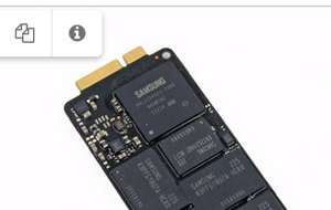

For the amount time you may be able to save, consider trying what I did. You’ll need an adapter or an enclosure that goes from Apple’s mSATA interface with a proprietary 7+17 pin Apple connector. I have included a photo to show the (likely PC only) associate at your nearest big box electronics store. Point out that it is Apple and won’t work with the PC adapter they hand you.

for reference when purchasing the hard drive enclosure or blade ssd to usb adapter
