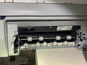

Pickup wheels not turning
same with mines... the rollers are not spinning after cleaning.. looks like the gears to turn the wheels is not engaging.
Pickup rollers make contact with paper. The printer motor sounds like it is running. However the pickup rollers are not turning.

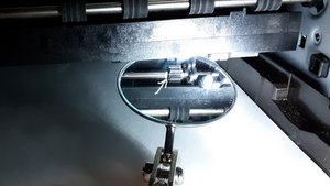

The source gear that runs the paper feed roller gear pack is stripped on the feed rod just behind the paper holding box top edge on the right. Use a mirror to look up inside the paper box at the source gear while trying to print and you will see the rod the gear is on is turning but the drive gear is not. The rod that drives the gear has splines on it that hold the gear in place, the gear is plastic! and the splines are gone on the plastic gear that keeps it turning with the rod.
I repaired mine by sliding the gear to the left so the splines on the rod were visible. Then I very carefully applied JB weld to the splines on the rod. (Note: do not get JB weld on any other place than the splines on the rod). Then I moved the gear back to the right in position being sure the drive gear and the feed gear were lined up. Let it dry 24 hours before using! Note: this all has to be done with a mirror, even if you turn the printer upside down you cannot see the drive gear and rod because you cannot remove the paper holding box bottom. Good luck!

One drop of superglue on the metal part and repositionning the gear. All seems to be Ok
No screw to remove.
Four hands and a video-microscope will be very usefull !

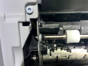

This fix worked. Here's another pic. Slide the black gear back onto the metal rod teeth.
I found that the gear that is shown in the above pictures on the arm that drops down had cracked and the splines on the shaft would cause the plastic gear to open up at the crack and not allow the gear to turn. That shaft with the gear will require replacement.

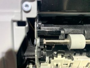

The shaft with the upper 4 grey paper rollers was not turning reliable because the plastic gear was slipping on the shaft. The shaft had slide to the side and the spline on the metal shaft was not fulling inserted into the gear.
The fix is to apply a tiny drop of superglue to the shaft and slide it ‘left’ to fully engage with the gear.
I suspect that this occur when someone aggressively cleared a paper jam at the back of the printer and didn’t pull the paper evenly.
Here’s the location of the gear (see left side of image)
Here’s the ‘before’ photo (see the shiny metal shaft spline to the right of the gear):
Here’s what it looks like after the fix:
