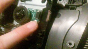

I have a question.. Hoping someone can help me.. I'm trying to figure out what white cable that is to the left of the disc reader is so I can purchase it!! So I can buy the right one
