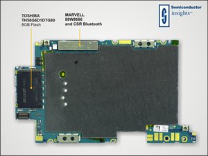

sorry to answer that late (ok, it's 05:42am ;-)) - i think it's a connection problem - so, yes - open it again and check all the connections, search for broken parts in the area around the "do not remove" sticker
CLICK for a HUGEer version of the picture
check both sides - the circuits around the golden spring are for the antenna - so if there is a problem - it might lead to those problems. surely - the antenny could also have a problem, but it's not an antenna in the regular way - normally - it fails because of a bad connection

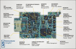

I just realized that I could do that when I updated. However I can only disable the 3G baseband. When I do so the connection drops within a few seconds. So I think it's safe to assume that the problem lies in the handling of non 3G signal. I just ned to identify the ICE's that processes that signal and find someone willing to check the BGA's for me.
right, you can only disable the 3g. identifying the parts isn't the problem - but the "new" ones are pretty expensive. "checking" bga's isn't an option. it might be one of the PA's and in that case, you might not even see anything. if the repair is possible - it could get pricey. if you can provide a "dead" iphone 3g for parts, it would get cheaper - but still - it's not done within a few minutes - those job's can take hours (i know that - i rewired those crappy nand flashes of an iphone 3g)
