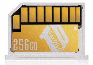

I found the TarDisk, when I was searching the web on how to expand my macbook storage.
I ordered it and it came last week and has been working perfectly! It doubled my MacBooks onboard storage. Check it out!
