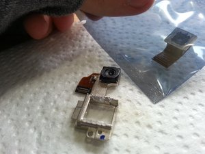

Short story, my rear main camera on my HTC one m8 is faulty. I bought an oem replacement and will soon take apart my phone. Question is, how do I get the rear camera out of the duo camera set up? I know how to take out the motherboard etc, but In photos of teardowns it seems that the rear camera and the extra duo camera sensor are connected together, and I am unsure how to remove my faulty main camera and then install the correct one. If any body knows what needs to be plugged in or can present theories of what is needed to be connected for re-installation I would be very thankful. Thanks.

So I ordered in the camera, than took apart the M8 by watching this tutorial on YouTube: https://youtu.be/CJtVKlmEbcU

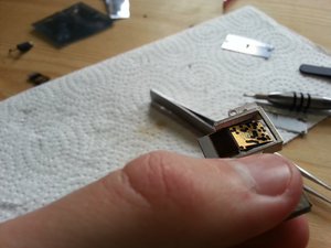

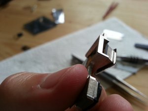

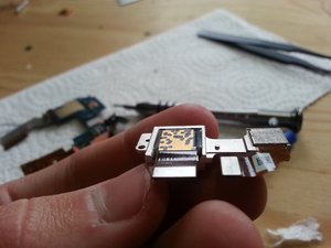

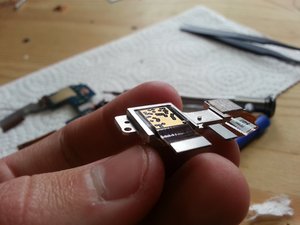

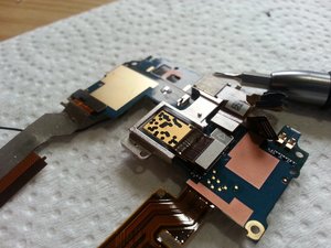

The rear camera and the extra duo camera sensor are NOT connected together. There is a piece of hard copper tape and glue holding both camera sensors in place in the metal frame. A little heat and exacto blade did the trick.
From there I put the phone back together and everything worked perfectly!
Hope this helps!
-Roman @romanakozak on twitter

Hi Roman. To get to the draughtboard (where the camera is) did you have to remove the main motherboard too? And also did you have to disconnect any cables or connections to be able to get to the rear main camera module? Thanks
