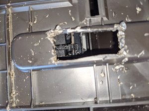

I cut a hole in the bottom and it was very easy to see the problem and access!

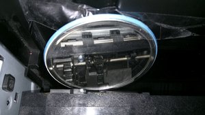

Here are 2 pictures to illustrate how to do it without taking it apart but by using a mirror to see the gear.
Global view to see where to put the mirror and where the gear is.
Zoom in on the mirror and you can see the gear and epoxy as it dries. You can use the gears to the left to rotate the axis and dab it homogeneously.
With the mirror it was real quick... Now lets see if it worked again...

Thanks for the pictures! I was able to access with a mirror, although I'll cut an access hole if it repeats. This site is very useful!
Stood hp 310a on its side. Positioned small flat mirror angled on its edge to view gear train. Taped drop light to now top of printer looking at the mirror/gear train. One small plastic gear slid off the steel shaft 'spline' not engaging drive train. (can move the gear by hand back in line with the gear train and try once to see if it fixes problem). Then slid the gear down & off the spline. Bent small hook in a wire. Mixed some two part epoxy and carefully dabbed small amount on the shaft spline until about 100% coated. Very carefully slid the gear with fingers back on the shaft spline viewing that it was centered on the mating gear. Waited until next morning to try printer. Now works great! Hardest part was manipulating the dabbing of the epoxy on the spline due to working with mirror image. My printer had little use as I have a second one that I use for everyday printing, so, wanted to save the hp 310 as my good scanner/color/printer. Thanks much for steering me in the right direction.. Joe

I followed suggestion from nickbeat76 - cut a hole in the bottom of the tray - much easier to see what you are doing and get the epoxy in the right spot - no mirror necessary.
Dremeled a hole, put on a bit of gorilla glue, just waiting til tomorrow to try. Thanks for the cutting hole part!

Same problem HP7520. Cut a hole in bottom using a small solder iron (didn't want to dremmel because i was afraid of debris landing inside causing more damage) and melted a small square plastic away. Slid the wheel to one side, some superglue on the metal rod, slid the wheel in place. Done.
Works perfect again. Thanks for all the smart people!

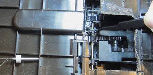

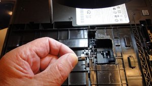

I had the same issue with our years-old 7520. The gear was pretty tight on the axle, and would turn most of the time, but not all... Like when it applied pressure against paper. I flipped the printer over and used a mirror to inspect.. eventually I found that the gear had a crack between two teeth.
I didn't want to take it apart and struggled to get epoxy in the right place so I ended up cutting a hole in the paper tray. Figured I'd upload the images to help someone else know where to cut if needed.
It's about 3/4” by 1 3/4”, cut with a Swiss army knife.. nothing special. Got me right where I needed to be.
You can remove the main paper tray (lower) on the HP B209a by lifting gently two triangle tabs. The tray slides forward. Then you can see the first gear that slid off the metal shaft and fails to feed paper. Bit of glue should fix.
