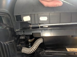

Glove box handle broke and I fixed it but have no idea how it mounts. Is there an illustration somewhere that shows how it mounts?

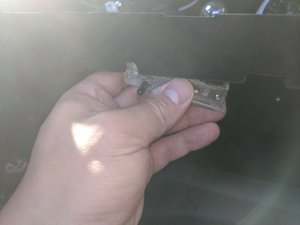

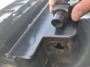

I recently replaced mine. Couple of screws across the top, two on either side, and one torx in the back. There's a vent tube that you place in after the replacement, and the valve connection for this you have to transfer from the old box (this was a very tight for both the old and new box so be careful, it's twist-lock, a lot of wiggling and cursing). You also have to transfer the light assembly, which removes downward into the box.
