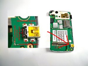

Recharging port is not connecting, how to repair?
Sometimes holding the recharging plug at a certain angle will charge, but it will not stay. Can this be repaired?

The moto q is charged via the usb port, the port could normally repaired - but that involves soldering
you wrote that it works when you hold it in a certain angle - sounds ok - but it isn't!
the more you bent it, the more damage could be done
is used a picture from the teardown to show you this:
to fix it, you have to resolder the broken parts - and it would be a good idea to check the 5 usb contacts to the main board - they break if they were bent to often
if the picture is to small, use the huge one
Try cleaning the lint out of the charge port.I had same problem ,so i took a pin and picked an amazing amount of lint out. Know it works like new.
