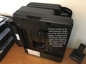

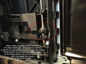

Hi George,
What better way to spend lockdown than to fix that printer.
I hope this helps and that you can see enough detail in the pics to see what’s going on.
Steve
Thanks for the pics. They were super helpful. I knew about cutting a hole but didn't know exactly where. I was worried about cutting into something critical but thankfully, with the help of your pics, I made a perfect cut. The cheap plastic cog was cracked and slipped off the spline which of course rendered the printer useless. I tried sealing the crack on the cog with Crazy Glue but that stuff didn't adhere at all. I then used an A+B epoxy mix called Plast-Aid that I butted up against the cog. I also filled the crack in the cog with the same epoxy using a toothpick as a tool. It all worked out perfectly. Now my printer is working fine again. Anyone trying this should wipe the cog and shaft clean first with rubbing alcohol. The good thing about the hole is that it's hidden underneath the printer and I know that if I have to do a similar repair in the future, the hole is already made and I will be able to fix it in two minutes. Thanks, Steve!

After inspection, I found out the culprit: all the gears within the feeder are working fine, but the first one, attached to the rotating axis, must be to old and it is not stuck onto the axis anymore. The axis turns fine, but it does not get the gear to rotate as soon as there is a slight resistance (which is the case when it has to push paper).
I do not know how to repair that. I may try to glue the gear on the axis, but my experience with this is not very good as the rotation is "brutal": it starts and stops violently, so the glue can only last a short time.

29th Jan 2018 - So now I have cut a hole in the base of the printer to gain access to the cog that drives the paper tractor. Now I can see whats going on.
On close inspection of the cog I found that it has split so it will never clamp onto the splined area of the shaft so it will be totally reliant on the glue to get it to grip to the shaft.
What I have done now is to apply some epoxy glue to the shaft, sliding the cog over the glue and add more along the shaft after roughing it up to give the glue a better chance to stick. and because I have placed the printer on its side the glue will flow over the end of the cog and end up in the teeth. When the glue set I cut away the excess on the cog teeth but leaving as much there as possible.
I am now going to let the stuff set over night before I try to run the printer, but if that doesn't work at least now I have easy access to the area through the hole in the bottom of the printer where the paper sits.

I too had and repaired this nusence trouble with the HP Photosmart 7510 printer. Attached are pictures:
1. cut hole in bottom of printer below the "pickup roller gear set".
2. slide "slipping" gear off to side and clean with alchol.
3. apply epoxy to gear axis with long wooden q-tip (or similar tool), then reposition gear.
4. let dry and start printing.
