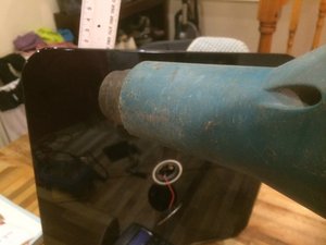

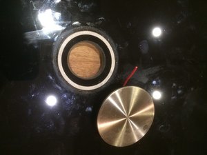

Step 1) Disassemble center button sensor:
Use a heatgun on the center aluminum button to loosen the adhesive, and insert a flat plastic spudger, working your way around the edge until it completely separates.
The sensor itself is a flat square sheet of copper, and is very delicately sandwiched between the aluminum button housing, and an inner plastic frame on the underside of the button.
Run a flat spudger or fingernail between the plastic and aluminum pieces, to separate them. Once the top aluminum housing is removed, you can delicately separate the flat sensor from the plastic frame, and remove the circular plastic frame.
Now, slide off the clip sensors from the glass sheet. You should have 5 separate sensors attached to the pcb.
Step 2) Remove glass top
Use a heat gun on each of the four corners of the glass top to loosen the adhesive.
Insert a plastic flat edge tool between the plastic housing and glass (at the visible seam where they meet), and separate one corner at a time, until all four corners' adhesive pads are separated and the glass panel can be removed.
Be mindful of the display while you perform this step, and don't run your flat tool in this area. Keep a good grip on the glass, so that it doesn't fall off when you separate the adhesive pad.
Carefully remove the glass panel, being careful not to damage the sensors in the middle. You may need to turn the scale on its edge to get a good enough grip to separate the panel, since the adhesive is so strong.

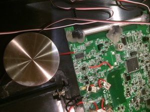

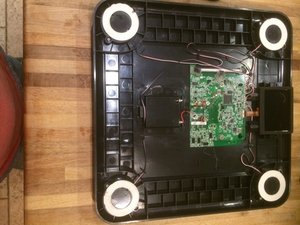

Now just scapped my second set of these scales. Both failed after 12-24 months.
Thanks for the teardown. I managed to get in, but no loose wires or clear problem area to fix.
I took photos along the way. See google docs.
https://goo.gl/photos/gmzFWdz769qiL42f6
The center disc came off very easily, but the 4 corner adhesive pads too quite a bit of leverage.
Also I had to cut the wire to the centre disc to remove the glass plate. The plan was to solder this back together if I got it working. The display ribbon cable came out by releasing the catch, but the circuit board was glued to the back plate.
Unless it is a loose wire, you would need to be an electronic engineer to fix it.
