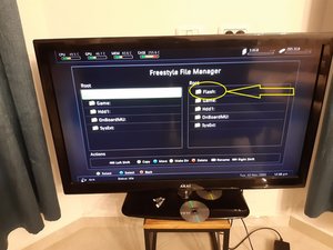

Is there a way to fix the xbox 360e  not working after wiping all files from the flash folder?
Is it possible to fix it without any tools?
The only thing that works is xell reloaded + Debian Mini LiveCD + gentoo livecd xenon and I can log in to the XBOX and see what's inside the root with WinSCP Program

can you help me when I deleted flash and clicked on xbox and return to freeboot and then ERROR E79 and how and how to fix it?
Nothing is working 😢
