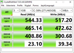

Have the similiar problem with my UX31E (mainly poor performance of the Sandisk 256GB rather than the SSD dying) and recently upgraded to a Samsung EVO 850 M.2 with a very small adapter on eBay which fits inline with the SSD. This means there is no problems with the back cover.
I know alexandremadurell posted the link, but it's well worth checking for anyone looking at changing/upgrading: https://jure.tuta.si/?p=40
There is a lot of information there and links to the different adapters including the slim-line adapter I used.

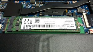

I had a 120gb sandisk ssd in my ux31a zenbook, and it was quite slow and space wasnt nearly enough for me.
So I went ahead and installed a Crucial MX300 275GB M.2 (2280) ssd using the full length adapter. In addition to that, I've also put some electrical tape on the back side of the cover there the ssd is just to create a "cushion" and/or barrier with it and the aluminum body.
No issues since the install and very pleased.
edit: You could essentially put any m.2 sata ssd, but it needs to be sata and not nvme (pcie).

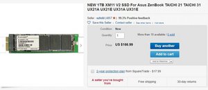

I am a fabricator of Custom Models and I looked long and hard to find a way to upgrade my Zenbook UX-31a to 1 Terabyte. Most people were satisfied with 256 and 500G, but not me! I have LOTS of Graphic Files and nothing less than 1 Terabyte would suffice. Finally, the Wait is OVER !!!!
. There is NOW some 3rd Party Vendors out of China that realize the significant demand for Hardware Drive Upgrades for the UX21A UX21E UX31A UX31E Zenbook platforms. You can google the following company below. I recently purchased the 1 TB made specifically for the Zenbook UX21A UX21E UX31A UX31E
500 G is now the norm for laptops and 1T will eventually be the standard. 128 and 256 Gig are no longer tollerable.
I will post more about my finding after this initial post is published.
NEW 1TB XM11 V2 SSD For Asus ZenBook TAICHI 21 TAICHI 31 UX21A UX21E UX31A UX31E
Item priceUSD 166.99
Regards, Herman

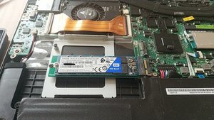

Hi there,
I just wanted to share, that I managed to replace the drive in UX51 using a regular SATA SSD and an adapter.
Adapter: Kalea-Informatique© - adapter M.2 (M2 NGFF B Key SATA)
Disk: WDS500G2B0B
The installed disk looks like this:
(I added the electrical tape on the cover just in case).
Some details of the disk here:
Hope it helps :)

I store a lot of images on my laptop and needed more space. I had to upgrade 2 times. 128G to 500G. Most recently 500G to 1TB. There is now a 1TB (1 Terabyte) option without the need for an Adapter on eBay. Just search for the UX Version along with the keyword
https://www.ebay.com/itm/223789789943
This solution does NOT require an Adapter, as a result, you don’t need to worry about the Thickness issue that others have mentioned.
Regards
Herman Bongco
Modelworks Direct
1-844-8MODELS
