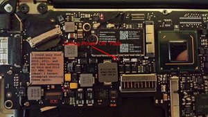

I found information for a 2010, 2011, and 2013 macbook air but I can't for the life of me locate the power pads for the mid 2012 macbook air 11". Here are photos and I hope a kind soul would be able to assist me.
I've only tried the flat head screwdriver method at this point but realized it wasn't a solder point. Yes, I'm an idiot =P
Here's a photo of the board and I just marked locations where I think it might be located based on what I've read.
I figure if powers on then I will replace the keyboard but if it doesnt then it would also involve the logicboard in which case I wouldn't bother fixing it.
Asahi, here you go. Do not bridge any of the other contacts you marked.
OMG!!! This worked!! Thanks oldturkey03 =) I'm sure this will be useful for all the other 2012 MBA 11"with the same issues. Thank you thank you thank you!
you are welcome;-)

See this Answer - your case is similar. Use care shorting random pads on the logic board, you can kill it.
