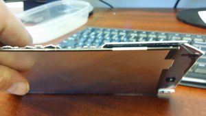

I am about to replace the glass on this iPad Air 2 White Digitizer right now. I will update with more photos once complete.

Please donot waste ur time Buying on Ebay Cracked Ipad Air 2, they are not Fixable, not body can do this...You Must BUY a Complete Panel to Replace only GLass for 250 dollars,,,Not Good.
Stay tuned ladies and gentleman. There will be a fix coming soon. It is possible and we are going to do it. I will keep you updated.

Hi, I'm a refurbisher. I have done several ipad air 2 glass replacements. It is possible but if you never have done it, it is not recommanded. Ipad air 1 and air 2 do not have compatible lcds. You cannot buy ipad air 2 lcd only without glass
I did do a repair once removing the glass cleaning the lcd and reinstalling the new glass without oca. You need some soldering, and some knowhow. Also, take into account that the space between lcd and glass need to been big enough not to have the rainbow effect (glass touching the lcd when pressed on). Ghost typing can be a problem as well if not done correctly.
It is better to use OCA (forget about LOCA), for best results but you need expensive machines to install that can handle the big 10-11 inch screen. Forget about oca if you do not have the right equipment.
Conclusion: if you never have done glass only repair on air 2 do not do it. A new once is expensive i know. :s

I have a screen separator machine and I have successfully separated the LCD from iPad pro, all surface pros and apple air 2. It just takes practice and don't use a customer's screen to experiment. I have successfully applied oca and installed a digitizer on surface pros but my next step is the iPad pro.
www.laptopscreenmontreal.com I think I posted a few pictures on separation.
