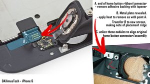

Hello everyone,
It appears that the iPhone 6 replacement screen assembly purchased from ifixit is not complete!
Note I speak solely of the (Glass,LCD, Digitizer option only) and can verify that it seems to be missing a conductive plate below the home button flex cable.
Below you will see the original screen on the right indicating the conductive plate B.
Follow ifixit home button replacement guidelines and be sure to take this plate B over to the new screen assembly.
Be sure to utilize heat when removing adhesive from ribbon cables.
I transferred my original home button to the new screen and got this working as outlines above.
Be sure to utilize the plastic nodules at C. to align the home button connector upon reassembly.
Let me know if anyone needs further clarification.
Daximus.
Thank you Daximus,
I did this change but doesn't work for me. Any other option?
Thank you
Same issue - same mother board/Tid, new screen, transfer and no fix. Tid works fine on cracked screen. confusing
My flex cable on plate shield was demage. I replace it, now works fine!!!
I've changed the flex and it still isn't working. Any ideas?
maybe the home button cable was brokened
