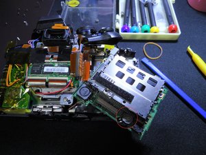

Why do I need to reset the camera date every time I change the camera battery.? Is there any internal battery that I need to replace? Thanks.

画像はE-420ですが、メイン基板を取り外し裏側にリチウムイオン充電池があります。オリンパス機だと似たような位置にあると思います。
刻印は621です。
Good answer! For those of us who don't speak Japanese, here's the Google translation of Shinobu Sato's post:
The image is E-420, but the main board is removed and there is a lithium ion rechargeable battery on the back side. I think that it is in a similar position if it is an Olympus machine.
The stamp is 621.
@dadibrokeit That's wonderful news - how does one get there?
@terrywilcox1795 Teardown information for SLR cameras is notoriously hard to come by. All I could find for this one is a guy who is showing how to replace the power button; not what you're looking to do, but the instructions will at least get you to where you can see the main circuit board that needs to be removed.

I'm in the process of changing this little battery on my E-400.
The internals look very similar to other models from this generation of cameras. I'll comment here when it's done.
