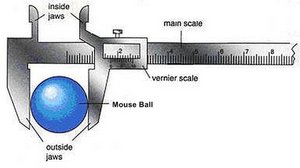

Something small and hard fell in the mouse track ball area and while i was pressing it (upside down) on a piece of paper to clean it, that little hard piece of dust, carved the surface of my track ball making it unable to scroll without jumping around!
So im now in the need of purchasing a new ball and replacing it! Does the ball as a part exist? Because i can't find anything on ebay! Any help?

genik, I am sure that you have already checked these instructions. Post an image of your trackball as well as the damage with your question and lets see if we can assist you finding what you need. If you can measure the diameter of the ball and let us know what you find. the scroll ball is nothing but a "rubber" ball with a metal core. I would suggest to measure the existing ball and get something the same (or at least very close to it) ball from places like this. Hope this helps, good luck.

any mechanic or machinist should be able to help you. All you need is a set of vernier calipers to measure it.

I thought by now you had found what you needed. Anyhow, the diameter is 7.15mm/0.2815inch
Hmm interesting, only i don't know how to measure exactly the diameter!
Is this tool offered in the Pro Tech Toolkit? Cause i see something similar... i think!
