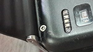

My gear 2 had damaged terminals ( charging pins located in gear s2 back .)
So I can not charge it.
Please is that terminals is replaceable.
And where I can fix it.

I have photo for my gear 2 pins
Same thing happened to me. I would love a remedy as well.

Same thing happened to me. It's clearly a defect in manufacturing as I did not abuse the watch at all and the pins are only ever touching your wrist or the charger.

I had the same problem with one pin damaged. They said corrosion. I was crook for months and hardly wore the watch. Went to consumer affairs but Samsung wouldn't back down. Pretty dark on Samsung over this
I have a Gear II. You are suppose to have 5 of the gold metal contacts on the back of your watch, and 5 pins on the charger. My watch only has 4 gold metal contacts. It won't charge anymore. I was having a difficult time charging it the last 3 or 4 times. and now it's dead and useless. I wonder if there is a recall for the poorly designed charging system they have for the Gear II? I'm going back to Best Buy tomorrow. They know us by name, we are golden customers to them. I'm sure they will take care of me. This is frustrating. I'm lost without it. I cannot miss doctor calls, etc. WHY WOULD THEY DESIGN THIS WATCH SO THAT THE CHARGING PINS ARE CONSTANTLY AGAINST YOUR SKIN? OH, I GET IT, SO IT BREAKS AND YOU BUY A NEW ONE? THIS SHOULD BE A TOTAL RECALL!

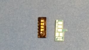

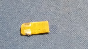

So finally after several attempts I now have a working home made replacement part. I started by removing the defective part from the watch back. I broke it open to see if there was anything inside as can be seen from this photo

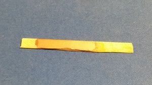

I then took a piece of printed circuit board and cut it to the appropriate width, then removed the copper from both sides to provide a conductive free board.
I did try etching my own board, but in the process of getting traces from one side of the board to the other, I found it easier to use this described method....

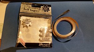

I used a sticky foil
that can be purchased from a crafts store. I then wrapped it around the board that was cut to size.
. Using a razor knife I cut the foil to remove parts leaving "traces" where I wanted the contacts to be.

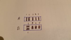

Follow the "wiring" diagram here:
Keep in mind that it is essential for the foil to line up perfectly on all five contacts for both sides of the board. It took me many tries to get it right, but finally it have it.

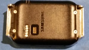

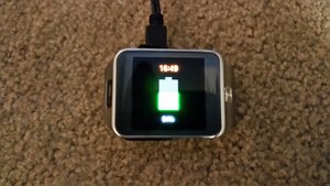

As you can see, it is now charging.
When building this part, be very patient as it took me about twenty tries to get the spacings, and distances correct so all ten contacts lined up.

After finishing this project last night, while laying in bed, I had an idea. Perhaps instead of the foil why not use conductive paint dispensed from a conductive pen? I am going to order one in and give it a try. If it works, it would be much easier and I could have a few spares on hand.
http://www.all-spec.com/products/Solderi...
Perhaps this conductive paint could be applied on top of the eroded terminals to "revive" it back to working condition? Something to try. I cannot as I purposely destroyed my contact strip to build a replacement one.
Update. I purchased the silver pen today and over the coming days I will attempt to build this part again using the pen. Stand by for my next update.

I got a replacement board from Stellatech in Europe. Part link. It cost 7 Euro's plus postage and VAT.
I have just replaced the small board in the watch and its happily charging. Once I had taken the case apart (Thanks iFixit! teardown link ), I used a small spudger to pries the board of the base. See here for an image of where to prise from
Its glued in (I assume to keep it water tight) and take a bit of effort to remove. Pulling by the little Tab actually separated the board from its backing! I used a thin layer of contact cement on the base.

I, too, had only 4 contacts... I went on ebay and found the terminals.. they were $6. took only a week from China.
I just changed it .. 4 screws on the back. popped out the current damaged contacts.. put the new one in.. replaced the 4 screws.. plugged it in and it worked.. it is charging now.. took 20 minutes.. Just need to have a screwdriver small enough.. I had bought a small kit in Micro center..
