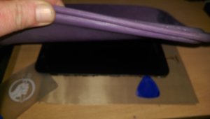

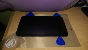

Ive just done a Galaxy Tab 3 digitizer & LCD replacement. I used a hot water bottle 1/3 filled with fresh boiling water. The reason for it only being 1/3 filled was - if you put too much water in the hot water bottle it almost turns in to an oval shape. So you have less of the bottle touching the surface of the screen. With 1/3 the surface of the bottle remains quite flat, so all of the areas of the screen become heated, softening the glue enough to get a scalpel or other thin sharp object in. Once the digitizer was off it was just a matter of making sure all the peripherals & ribbon cables were disconnected from the logic board. Then place the exposed lcd side of the frame back on to a refilled 1/3 full hot water bottle. I found a small amount of adhesive holding the LCD to the inner frame. Once warmed up enough i then gently pressed the lcd from the inside part of the frame until the complete LCD just popped out.

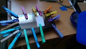

After i was happy with the positioning i then reheated the front of the digitizer on another 1/3 full hot water bottle & then clamped the digitizer down with around 15 or 20 clothes pegs. This put just enough equal pressure all around the glass to the frame. Then i left it all to cool down for a couple of hours.

1/ Heating up the digitizer for gentle removal
2/ Gradually working the digitizer free
3/ Clamping the new digitizer down with clothes pegs while the adhesive cools & hardens
